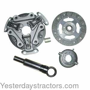

Clutch Kit - Carbon Release Bearing
for Farmall Cub, Cub Lo-Boy Tractors
118503 Clutch Kit - Carbon Release Bearing 118503
  • For International / Farmall tractor model Cub (Lo-Boy)
  • Replaces International OEM number 251266R1, 350921R11, 351760R91, 351773R91
  • Clutch Diameter - 6-1/2'
  • Clutch Hub Diameter - 15/16"
  • Clutch Splines - 10
  • Clutch Center - Solid
  • Clutch Type - Woven
  • Pressure Plate Size - 6-1/2'
  • Pressure Plate Levers - 3
  • Pressure Plate Springs - 6
  • Pressure Plate Type - Single Stage
  • Pilot Bushing, Release Bearing (carbon) and Pilot Tool included
  • For Pressure Plate use Item #: 114935
