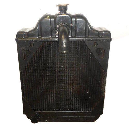

Radiator using 7\8 inch Male Oil Line Fittings, Premium Used for Case 430
Case 430 Radiator using 7\8 inch Male Oil Line Fittings 309988
  • For Case tractor models 430, 530
  • Compatible with Case Construction and industrial models 430CK, 480B, 480CK, 530CK, 580B, 580CK
  • Replaces Case OEM number A39345, A35583
  • Overall Height: 26
  • Overall Width: 19
  • Core Height: 18-1/8
  • Core Width: 18-1/4
  • Depth: 1-3/4
  • Rows: 3
  • Fins Per Inch: 8
  • Fill Neck Height: 1-7/16
  • Inlet: 2
  • Outlet: 1-3/4
  • With Oil Cooler on grille side using 7/8 -14 UNF Male fittings
  • Our premium used radiators have been cleaned, inspected, and pressure checked
  • For a new version of this item use Item #: 101671
  • Additional Shipping: $27.95
Item #: 309988
$332.01
