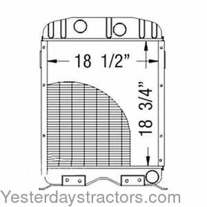

  • For Ford tractor model Major
  • Replaces Ford OEM number E1ADKN8005E
  • Overall Height: 24-7/8
  • Overall Width: 18-1/8
  • Core Height: 18-3/4
  • Core Width: 16-1/2
  • Depth: 2-1/2
  • Rows: 3
  • Fins Per Inch: 8
  • Inlet: 1-3/4 Remote Fill Connection
  • Outlet: 1-3/4
