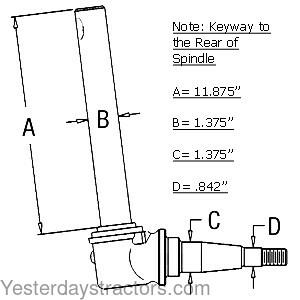

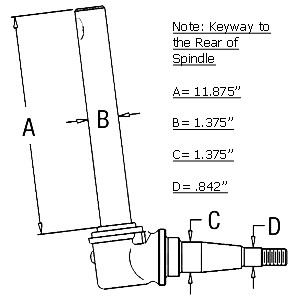

Vertical shaft length 11.875 inches, shaft diameter 1.375 inches, spindle inside bearing flat 1.375 inch, spindle outside bearing flat .842 inch. Keyway is to the rear. REPLACES: AR52861. Fits 1020, 1520, 1530, 2020 (swept back), 2030, 2040, 2240, 2440 (< serial number 340999), 2630, 2640 (< serial number 340999), 820, 830. Wheel Bearing Kit available separately part number WBKJD3. Replaces AR103472, AR52861. Reference ID: AR103472
