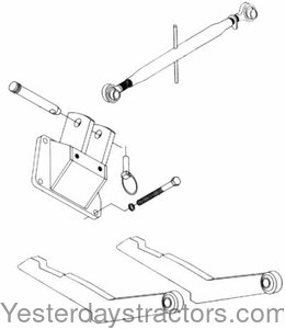

do a search for 2 point conversion prongs. Kim has one listed here
