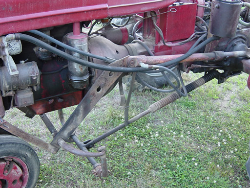

I have used A for 20 years to push snow. Blade is controlled by mechanical means. This is operated by left hand. Right now my lefty is not doing too good and snow is comin'. Is it likely I can reconfigure blade lift to right hand? or would hydraulics be necessary. Right now I can't get out to look at it. Also use belly mower in summer, but not absolutely necessary. Thanks a million to great guys on this forum.

Here's the hydraulic set up on my A:
third party image
third party image

kopeck
01-15-2008 18:23:34
Report to Moderator
 Re: Snow blade on Farmall A with no hydraulics in reply to dave guest, 01-14-2008 21:03:57
Here's the setup on my BN. It has a fancy bracket that attaches to the generator.
third party image
The belt will slip from time to time but it needs a new belt.

A co-workers neighbor put a blade on his A. He used an ATV winch, mounted on the back of the tractor, with pulleys and cable to raise it.
Is yours 12 volt?

I mounted a blade to the right, right on front of my belly mower.It is angled somewhat. I had a hand lift that was a arm killer. I hooked up a 12 volt electric cable winch.I mounted that right under the seat. I put a pulley where the lower hand lift is, their was a bolt area. I connected the end of the cable to the belly mower. I can move the blade up or down with a button now. Works good for me. That hand lift got tough after a while!!! Steve

Small tidy remote resivoir pumps are found on Subaru and honda autos. They are not a problem to mount, and are by far less bulky. JimN

Dave, I don't know about converting to right hand, but imagine it can be done. Hydraulics can be added with a power steering pump from a car or truck. Have seen lots of them rigged this way and work fine.

Years ago I had a B which also didn't have any hyds. on it and I rigged it up so I would have them. I used a power steering pump off an old Chev pick up and a control valve. I used it on the sickle mower I built to fit under the belly of it. I mowed hay with the rig for a good 5 years before I got a MOCO to replace it
