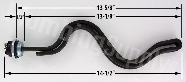

Typically, for a full-size WH, element length is all about quality/watt density.
The shorter the element, the CHEAPER and watt density the highest.
The best quality/longest lasting elements are LONG and curvy, for the lowest watt density. In other words, they distribute the heat energy over a lot more surface area.
Some of the best/longest-lasting elements for use with hard water are the "Sand Hog" units.
third party image
Of course, I'm sure there's guys out there that are gonna say they have the WORST luck with those!>
