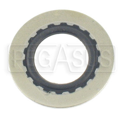

Many newer vehicles use a "Dowty washer" AKA a "Stat-O-Seal" washer on the oil drain plug that will seal if the plug is even finger tight.
The only reason the plug needs to be any tighter is to be sure it doesn't vibrate out later.
Yet a BLEM at an oil change place will mangle and strip those plugs without any consideration that those washers need to be replaced once in a while.
