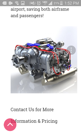

A company has been developing a flathead airplane engine. The latest is the D-Motor LF26. 2.7 litres, (165 cubic inches), 88 HP, flat four, water cooled engine. 8.1 compression ratio and burns 91 octane pump gas.
https://en.m.wikipedia.org/wiki/D-Motor_LF26
From Wikipedia:
"This direct-drive aero-engine is unusual in two respects: it is very oversquarewith a bore:stroke ratio of 1.295:1, and it has a side-valve (flathead) valvetrain. The designer determined that since maximum continuous power output (65.3 kW[3]) was to be developed at only 2800 rpm, the extra weight and complexity of overhead valves (OHV)would be superfluous."
They claim that at lower RPM (2,800) that there is no advantage to overhead valves, and that the flathead design has several advantages, some of those being simplicity, lower parts count, and that a valve failure does not take the engine down. They claim that their combustion chamber design with its "squish effect" gives very complete combusion at the RPM level it runs. I am guessing that the electronic fuel injection helps tremendously over carburetion.
4 cyliner version: https://youtu.be/WOD2Us4rtn8
