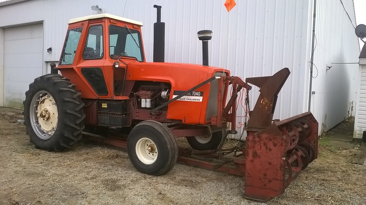

Get the smaller one. I used dad's rear mount three point blower before getting this front mount. Light snow does not pull nearly as hard as wet heavy snow does, so too much power is about right. Slow ground speed for the tough going, then higher when it's easy so a Hydro or power shift is best if you have either one. This tractor will pull 155 HP on the dyno, and sometimes in power shift first this seven foot blower will make the tractor grunt.
