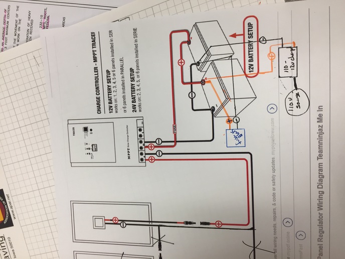

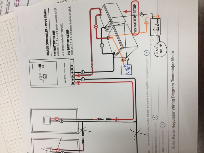

Help with some wiring please
Posted by case e on March 13, 2019 at 08:59:17 from (174.255.10.90):
I am in the planning stages of building my own pickup camper. I would like to have a battery bank of 2 deep cell 12 volt batteries and i want to be able to charge them with a roof mounted solar panel as well as a 110 volt battery charger. I want this to be all hard wired but was unsure what I needed to get this done. I will be running a few led lights and a small 12 volt tv as well as a ppace to charge my cell phone and laptop. I found this schematic and tried to modify it for my needs. The question is will it work and any advice on making it better or easier or cheaper. Thanks
