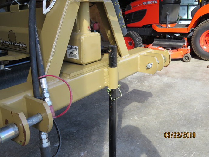

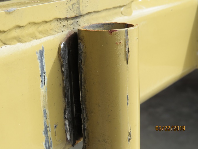

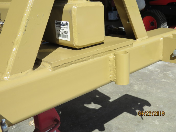

Don't you just love buying something new and discovering it has flaws! Bought the new 3 way back blade about 1-1/2 yrs ago for other place to use on drive and ditches. First off the cat.2 quick hitch was too narrow by about 1/4" for my JD old style quick hitch and had to beat apart with a sledge hammer in four different places. Got on tractor then discovered the parking stand would not raise enough because bracket welded on wrong and had to remove stand when using blade. I brought home and did a little weld cutting, welding and painting.
