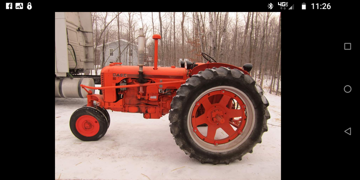

That icing is common on those
old cases and shouldn't hurt
anything. If the icing is just
some light frost for a few
inches above the carb it is
normal. If it gets thick or
covers the whole intake then
you have an issue. If it is
normal levels then I would
look elsewhere for the
problem. Here is a pic of my
DC running.
