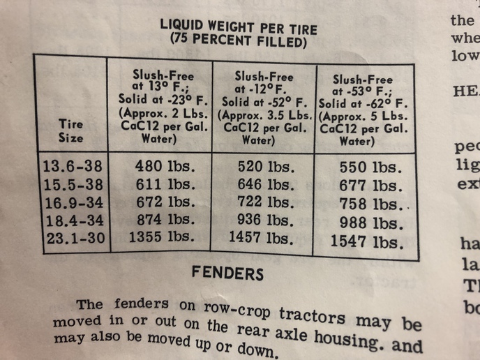

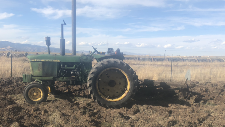

A dual on the land wheel helps put more power to ground these tires are filled to the max with the heaviest mix of calcium available
