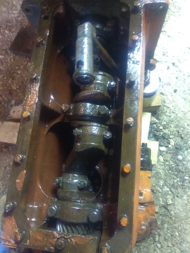

Got this back in December. Seller said it was loose last year. Well........it's stuck now. Drained oil, 1 quart of oil ,5 gallons of water. Pulled plugs filled with ATF. Sat for a couple months. Nothing. Pulled head, cylinders had water in em. Uggggg. Filled with some penetrating oil, been setting 2-3 weeks. Today took motor off and flipped it over. Will let it soak from the bottom for a while. If that don't work I will attempt my first rebuild.
