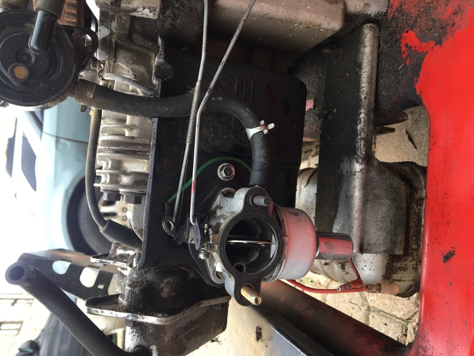

Posted by Northvale PA on April 28, 2019 at 19:10:14 from (24.112.156.180):
