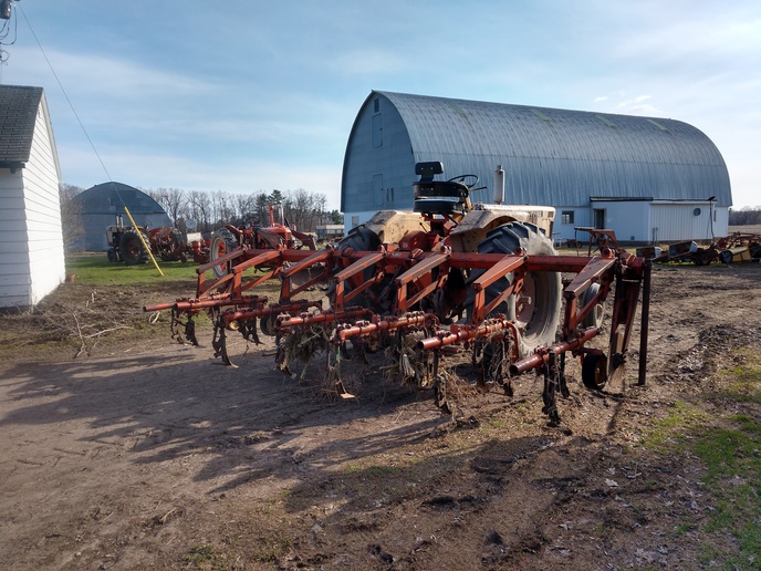

Finally got everything ready for planting, I think. Started by bringing more stuff home from where it was stored. I'll use the cultivator this summer I hope, I will change it to 4 wide.

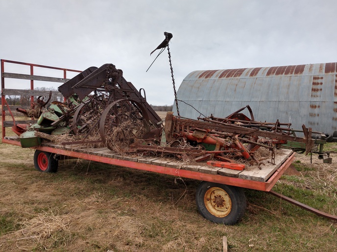

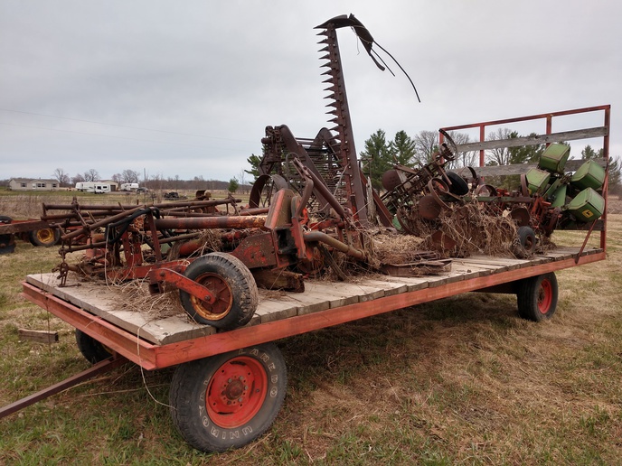

Also brought home the last of the "stuff". There is a couple mowers on there, a potato lifter/sorter, a couple mounted cultivators, and some parts.

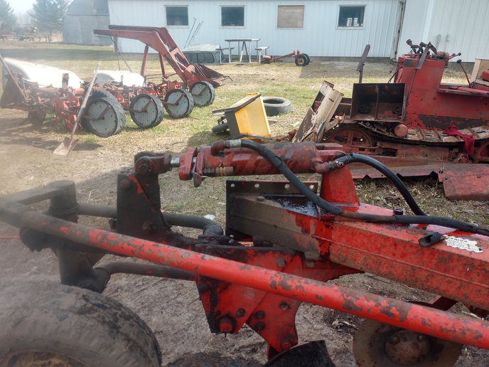

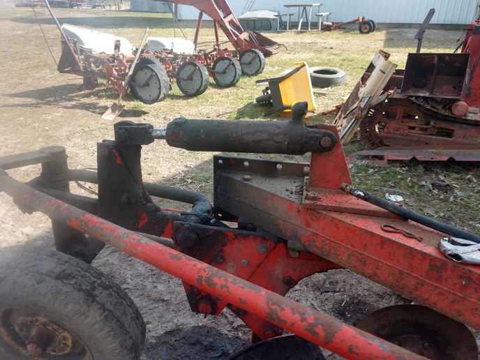

Then I replaced the cylinder on the plow I picked up last Monday. Thought I might get to try it out this weekend, but it got cool and cloudy so it didn't dry out much. The cylinder on it was leaking badly, of course it was an IH. Lol. I replaced it with a much better case cylinder.

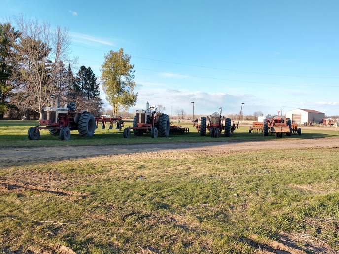

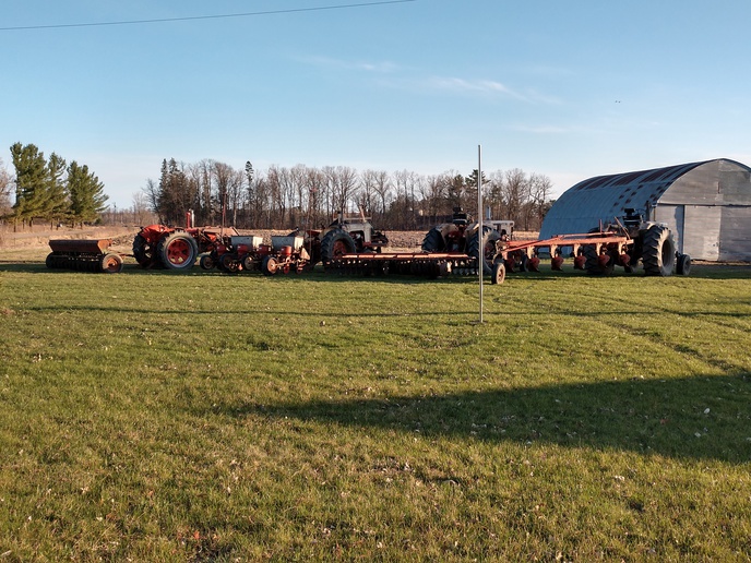

I even got a chance to take a pic of the crew.
When I started putting them there they we're in the sun, but by the time I was ready to take the pic they we're in the shadow of the barn. Oh well, I'll take another some day.
