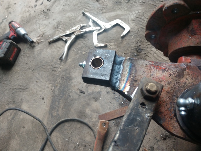

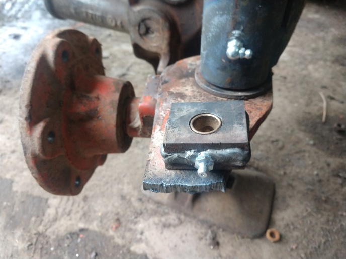

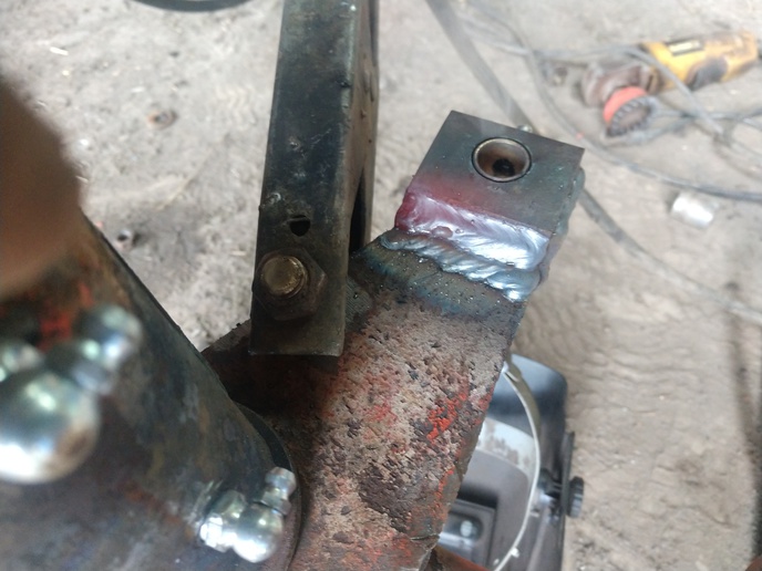

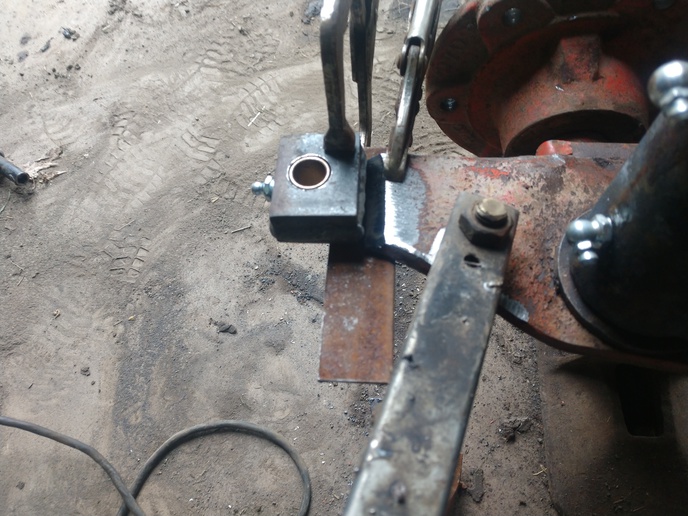

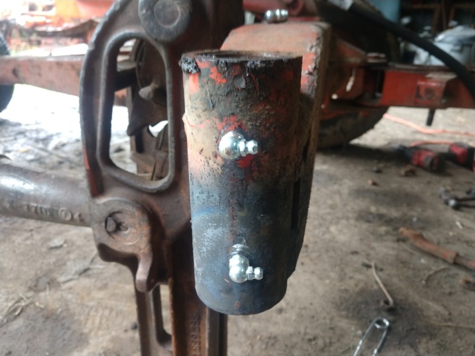

The spindle on one of my wagons siezed and broke the spindle arm and bent the tie rod. This was a poor design because they put just one grease zerk towards the top of the spindle so the lower part didn't get grease. Just a little heat to get it out and I drilled and tapped the lower part for a zerk.
Then I made a new block and bushing for the arm. I made it thicker so it will wear better.
I did both sides even though the other side was ok.

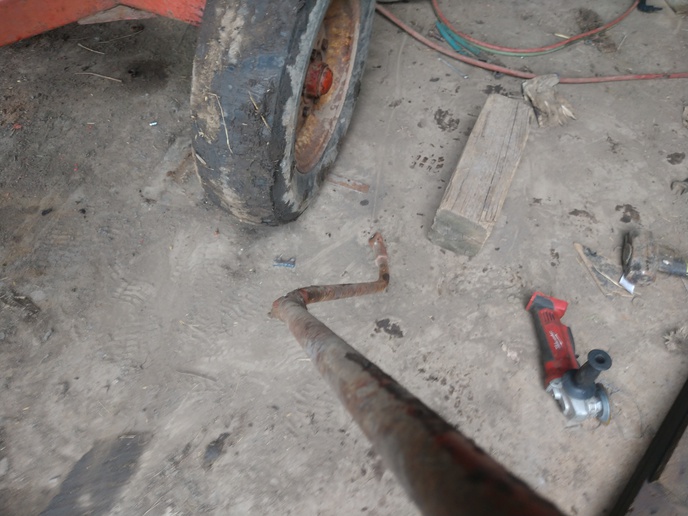

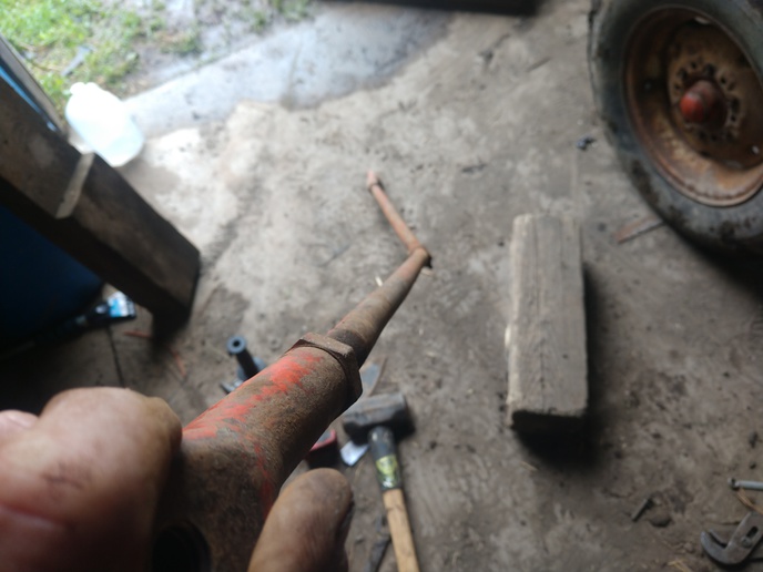

Then some time to straighten the tie rod.

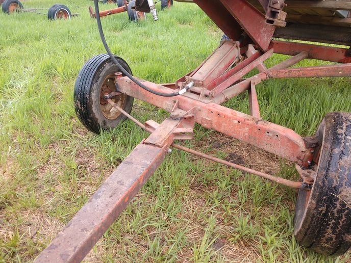

All better now.
