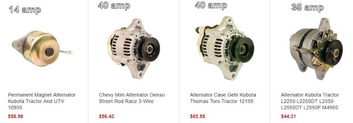

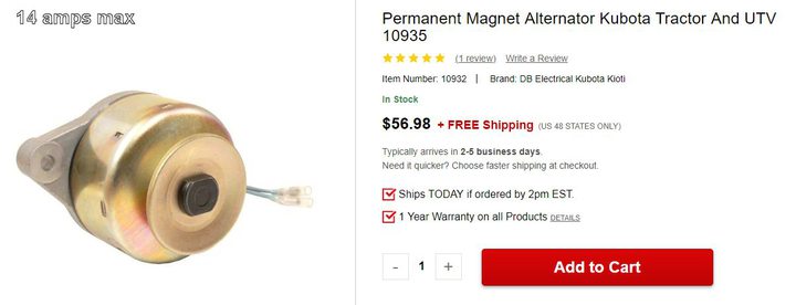

On the same subject, there are also now low-priced permanent-magnet alternators/generators. $50-$60, tiny, and rated 14 amps. Price is kind of amazing since not long ago - Delco 10SIs were being converted to permanent magnet and selling at times for near $200.
So just in case someone needed a really tiny alternator with no field-current power needed, here it is.
14 amps is plenty for many small tractors if mainly just for battery charging and maybe a few lights once in awhile.
One drawback is the belt pulley on these little units. I do not know if a wide-groove pulley is available.
