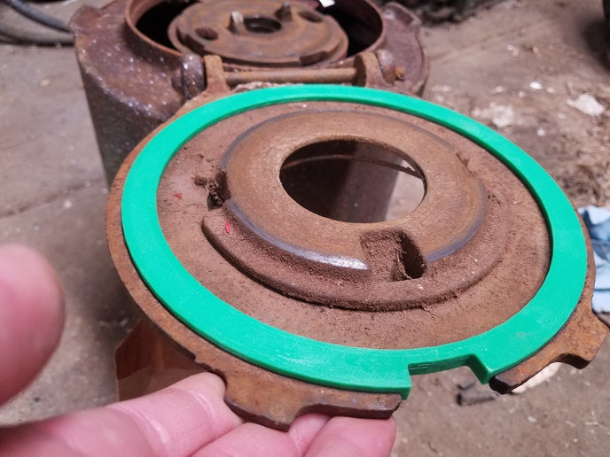

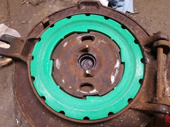

I plant my garden with a JD 246 planter. But I always forget to look for plates for popcorn. This year I designed one in Solidworks and made a set with my 3d printer. It took 13 hours to print 2 thin plates and 2 filler plates. And it took 30 seconds to plant 2 rows of popcorn. At least my back isn't sore.
The cells aren't perfect. About 50/50 singles and doubles. Occasionally 3 or 4 seeds at once.
