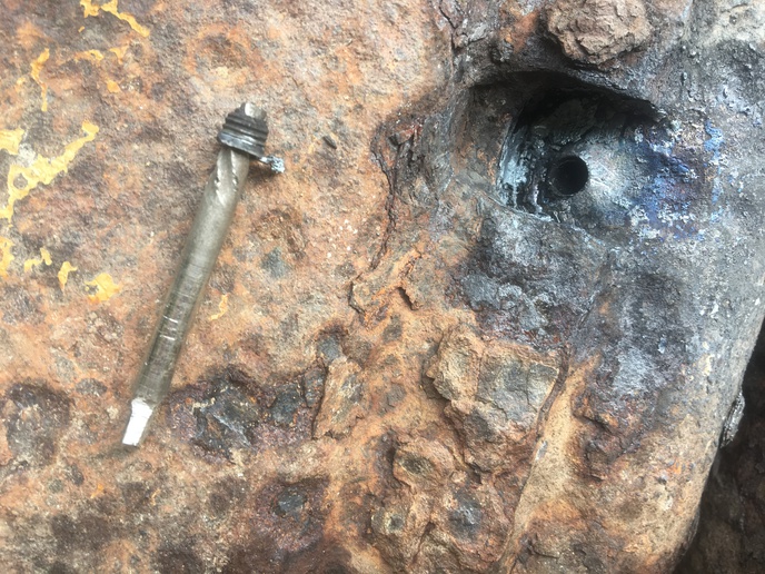

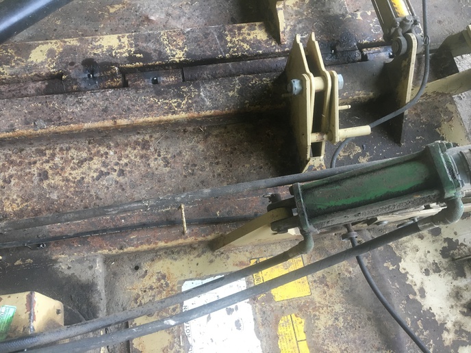

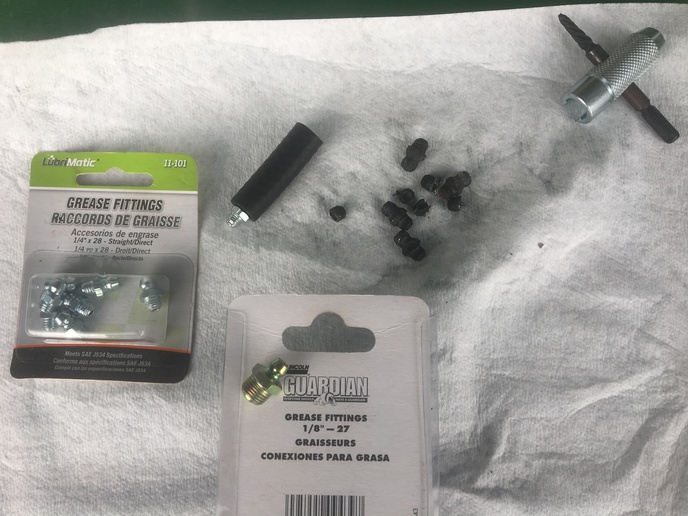

I went to Fastenal and found out they are only wholesale now. Drove to Farm & Fleet and got grease zerks and a nifty little tool with a easy out on one end and a tap on the other end. Stopped at Harbor Freight and got a set of left hand drill bits. I got a few out with
small vice grips, had to cut some off flush with a chisel and drill out and a couple with easy out. Not
enough room to use the nifty little tool for $12.00. Now I am confused, 1/4 “zerks are smaller than 1/8”zerks. Anyhow, got it done, all took grease but 3 of them and they pushed grease out around the threads. I will try to tight
them some more tomorrow, but not real confident it will help. Thanks,Chris
