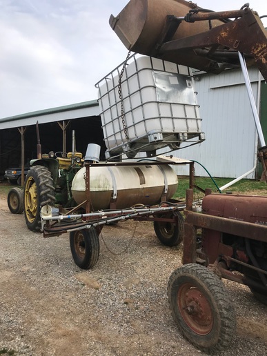

I have been putting it off but It was time to replace my hypro 7 roller pump. I ordered an 8 roller silver series as I have been spraying nitrogen the last 4-5 years. Best price was TSC actually. I have had the sprayer about 15 years and the pump was ?? old then. I replaced rollers, seals and bearings over the years.The shaft is worn bad so it leaks. And, even with new rollers, it just couldn’t pump 20 gpm thru each nozzle steady. The new pump cost more than I paid for the entire sprayer.
