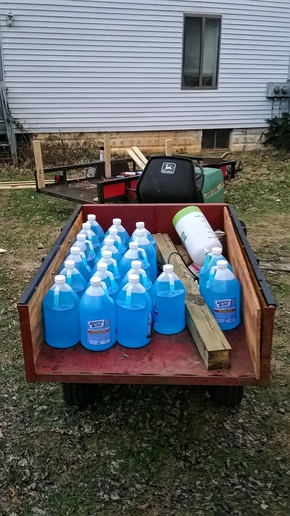

Read through the replys. That salt will rot evrything out if you don't catch it or fix it. Now after you replace your rims. Last fall around November Home Depot had a special on -20 ° Washer fluid for $.98 per gallon. I bought ten and then a day latter bought another ten. There were a couple waging tongues saying what in the world will you do with all of it. Well I sold a coulpe to a neighbor, used four in my Expedition, all but one remaining bottle went in the rear tires of three lawn and garden tractors. It drops the center of gravity several inches on lawn tractors and it gives you much better traction. ONE bottle left. Works great although just a bit lighter. Doesn't rot stuff and low toxicity. This fall if Home Depot has the special again I think several cases will follow me home.
