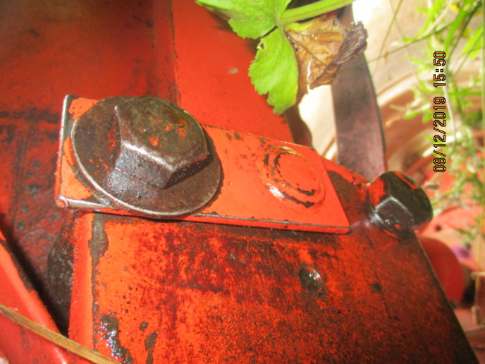

Bruce, here is a picture of what you can do to improve the pin. Case did this on late 30 series and 70 series. Rather than relying on a small tab and a 3/8" bolt and bushing, they welded a heavier tab and utilized one of the 3/4" bolts that hold the whole 3pt and drawbar bracket to the transmission housing. Don't forget to install a bushing on the bolt so the pin and tab assy can float.------Loren
