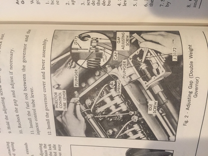

Ollie, Did you pull the valve cover? It’s simple if hoods not in
the way. Make sure your linkage works freely. The 3-53 that
everyone said would never run again is still going that we put
in the roller. Drove it all over our township.Best thing we did
lately with it is had the starter rebuilt. Now she turns over!
What machine is it in? Picture is a 6-71 but ours was kinda

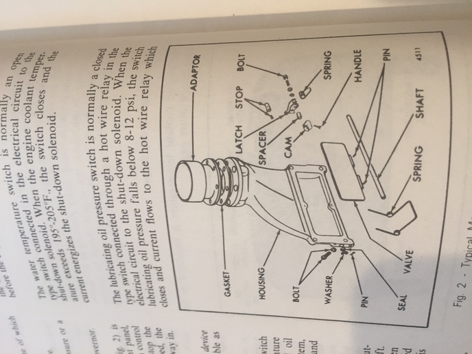

sorta the same idea. The injector control should work with
ease. Same with the emergency shut off ours is spring loaded
