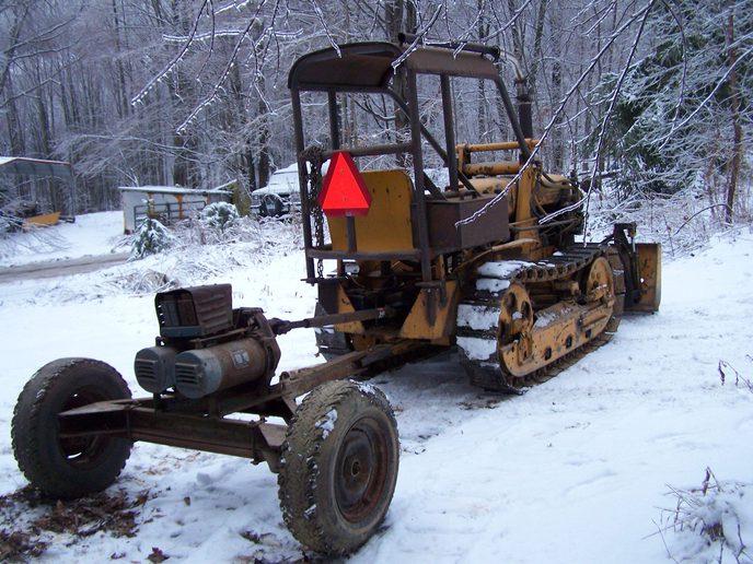

I have a 15 KW PTO generator I have used many times over the years to power my house. Nice thing about it is there is no extra engine to worry about getting running. I even hooked it to my HG Oliver crawler one time and even though it rated 20 HP max, it did fine. That is one nice thing about the setup. You only need enough HP to handle whatever load you call for.
