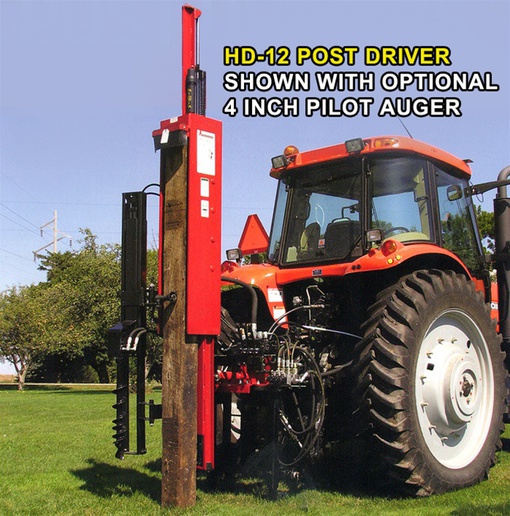

That is all the deeper you set posts???? I set line post 3-4 foot and corners 4-5 foot.

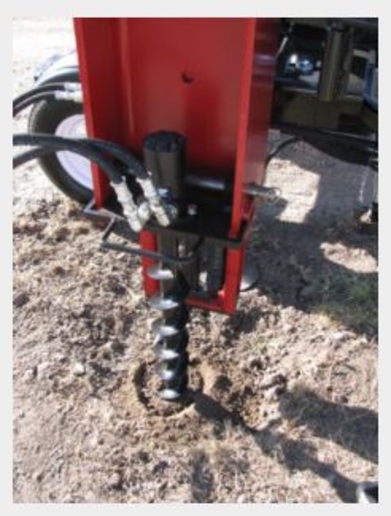

I drive my field fence posts. My driver has a small 4 inch auger that you drill a pilot hole with and then drive the post into it. Nothing to back fill and still have a straight post.
On large corner posts or ones that have to be an exact distance, I drill holes but back fill with clean 3/4 stone. In dry conditions like you have the side walls are like concrete. That stone will make the post darn near as tight as concrete. I like doing them that way as the posts seem to last longer here.
I have a Shaver HD-12D driver with the pilot hole auger. It was not cheap but I have built miles of fence with it.
Here is a driver like mine. You can see the auger swung out of the way to drive.
Here you can see the auger in use.

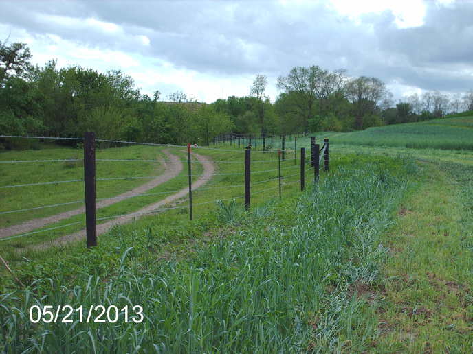

Here is some of my fence. Not as good as looking as yours though.
