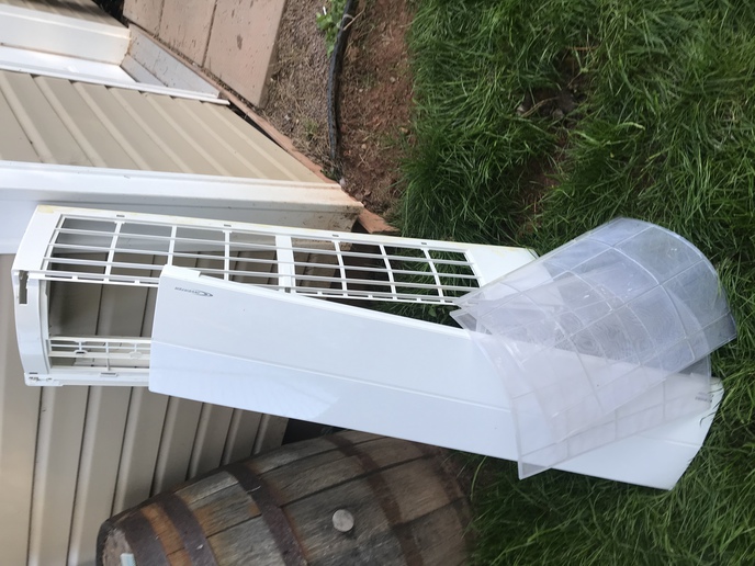

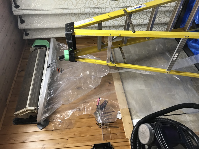

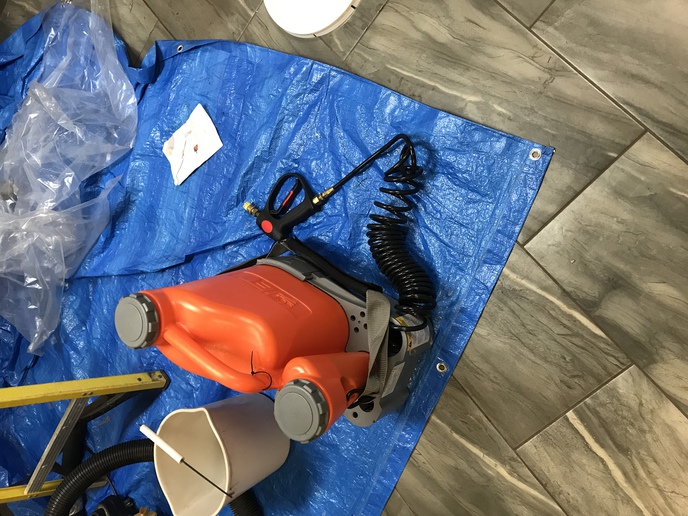

My electrician friend asked if I could give him cleaning an indoor unit of a heat pump at a pet boarding facility this morning. We turned the power off, removed the covers and taped off the terminals. We used a shop vac to clean off the loose pet hair than bagged it off. The red unit on the floor is a coil jet ,basically a self contained battery powered pressure washer. All of mess is collected by the bag and drains into a bucket on the floor. The whole procedure took 2 of us about an hour.
