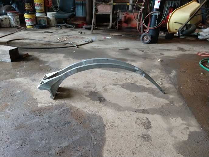

Got these 4 baler needles in the mail this week. They are in rough shape.
All 4 broken twice and bent and pieces missing from 2. Going to be a fun project.
Started by grinding and cleaning them out.

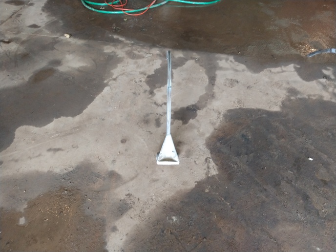

Used the Tig welder and 5356 rod to weld them. Ran one pass on the first side, then turned it and welded the other side. With Tig it's easy to get down in there and get full penetration.

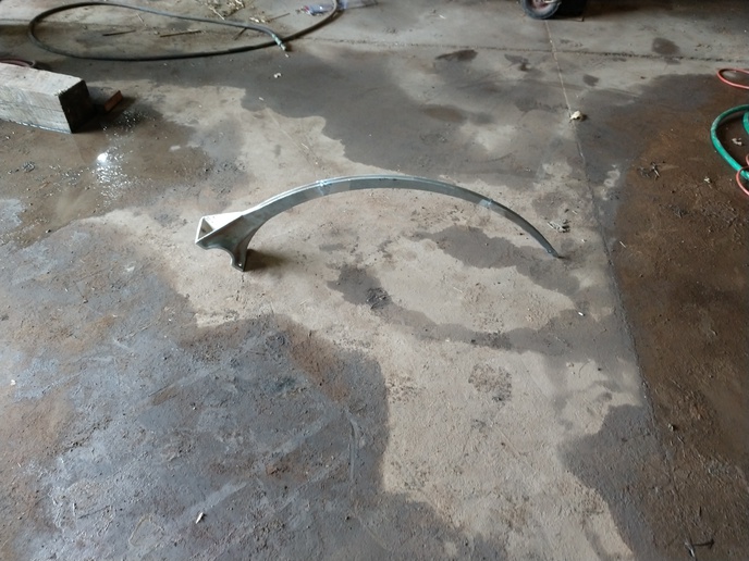

First one done.

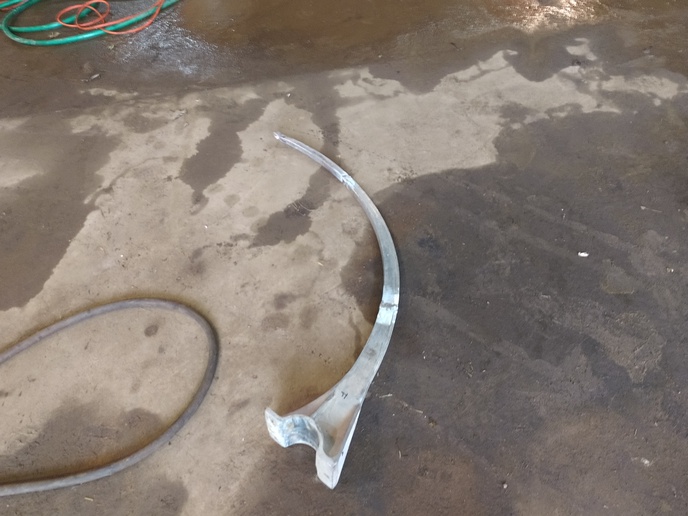

Got the second one welded too, you can see how far out of shape they are before I took the hammer and block of wood and rail road track to them to shape them.

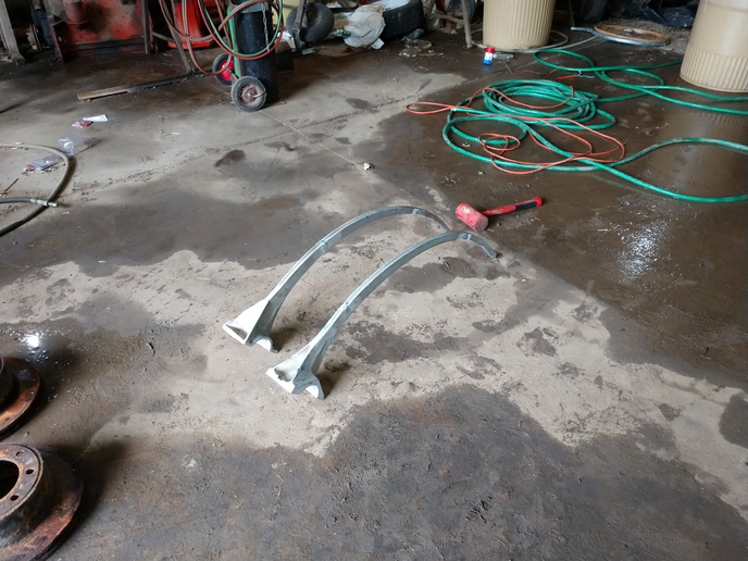

Eventually I got them to match pretty good.
