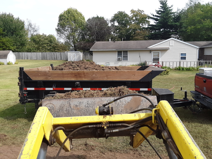

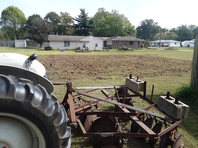

I used disk
to remove 5 loads of sod.
Loaded sod in dump trailer. Also removed
Sod from higher ground to north of place I plan to build on.
Then used disk to loosen a 6 inch crown.
Used terramite to remove crown and move dirt to eyeball level. Filled about 3 inches of the lowest corner before shooting grade. Then attached string to stakes and V-shaped grade. Going to roll tomorrow. Pray for rain. Let dirt settle. Then repeat until ground perfectly level.
This isn't my first rodeo. A quarter inch equals a yard of concrete, about $100.
