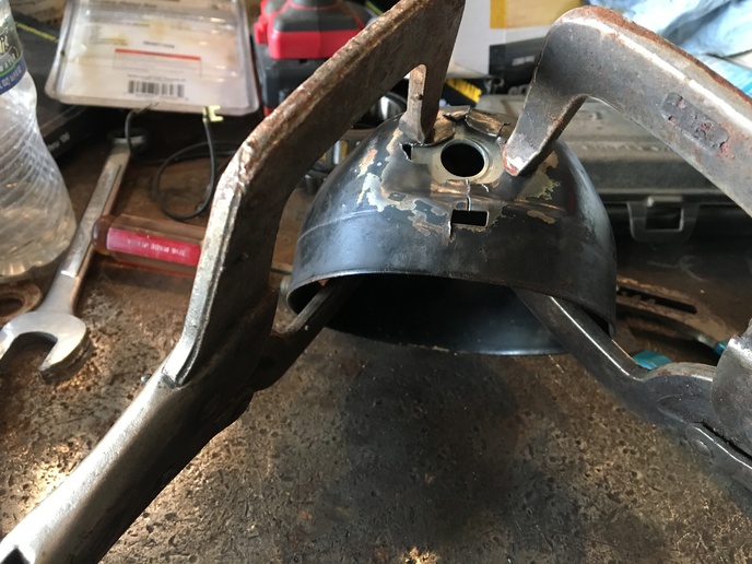

Sometimes you just have to try to fix something just to see if you can.
The bottom was tore up on this light and I felt the challenge of trying to fix it.I hammered on it a bit and clamped a washer to it and brazed
it in. Then I put a new bolt thru the spacer and brazed it on. Last I welded the bolt to the washer.
Looks like it will work to me, just wish it was warmer so I could paint it.
