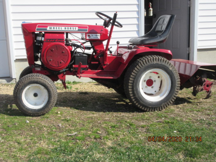

If the engine is sleeved it's pretty easy to drive them out. I used a block of oak and a 4 lb hammer and drove these out from the bottom. I have other engine parts so I just scrapped the rods but as suggested, you can just cut the sleeves off with a slitting wheel to get at the wrist pins.
