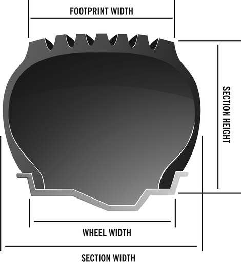

tire sizes are a nightmare of manufacturers internal choices. The chart I include has one manufacturers data. The difference between the two izes from
different producers can nearly overlap. It also depends in the aspect ratio. and that is also a played with number. Simple way to think of aspect
ratio is to look at a 2018 car with those wheels and tires that are mostly wheel with tiny little rubber stretched around them. compared to a front
tractor tire from a B John Deere, that has a real sidewall but narrow. Width to height of section. A tire is looked at as though it is cut in half,
and only one cut looked at.
The section height to section width is this ratio. a 70 series (ratio) tire is 70% as tall in section as wide in section.
Because tractor tires do not often have series number, there is substantial questioning of mounted and pressurized size.
Unloaded total standing height is also given for some tires. This is total height when mounted and inflated. Just buy what you want in pairs. Jim
