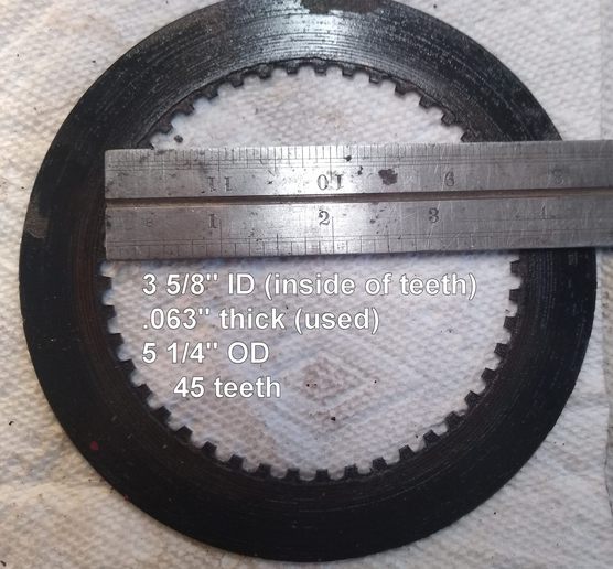

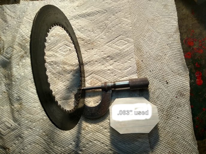

The clutch assembly has 8 steel plates and 8 friction disks. The friction disks are approx. 5 1/4" OD, .063" thick (my used disks), have
45 teeth on the ID, and approx. 3 5/8" distance for the ID. The disks are metallic and look very similar to what John Deere used to have
in their hydraulic reversers in the 350 crawlers. I know in the Deere machines, the clutches were made by Twin Disk Inc.

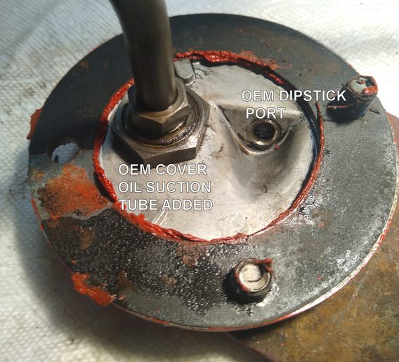

The round side-plate on the "passenger side" that has the hydraulic dipstick is OEM but modified for this kit. The dealer would of drilled
it and added a hydraulic suction tube.

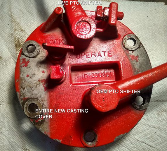

The round side-plate on the "driver's side" is completely new and comes with the kit. It carries the OEM type mechanical PTO lever, along
with a second "live PTO" lever that operates a hydraulic control valve. That valve is built into the cover. It is bare-bones simple. Just a
piton and a spring. No soft seals inside. When you put the live PTO lever into "engage" it puts pressure on the spring and piston an
raised hydraulic pressure that locks up the clutches.
I guess that is about all the info I can come up with. If someone on this forum has a source for new clutch disks that do not cost a small
fortune, I'd like to know about it. When I last worked at a John Deere dealership in 1991, those disks were near $40 each!!
