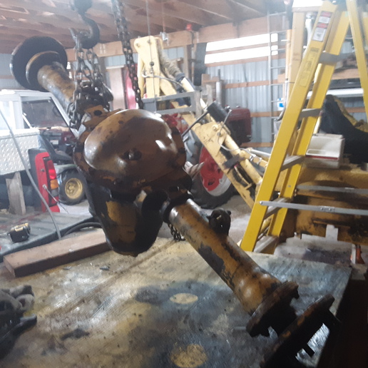

Over Thinking can get you into trouble.
I decided to put axles back in. Over
Filled rear end will 10w30.
This way I can test seals on axle, pinion and tube.
So far no leaks.
Sometimes you get a leaky roof but the leak isn't directly above where the leak is.
I think I have a hydraulic leak that ran down a hose and dripped on the tube.
Going to
Tip it other way tomorrow and check other seal and tube for leaking.
So far I'm winning.
Waiting for separator.
Hopefully I can do as Bob recommend. Replaced the gears, get a shim same thickness as the one that broke.
