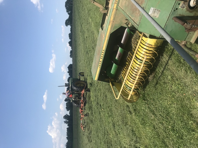

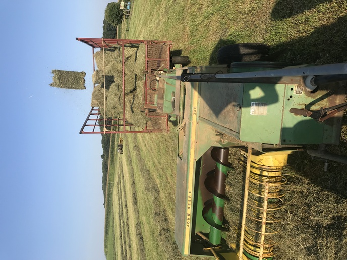

I have a 4 star Kuhn and a reel type 7’ Grimm. We use both. On alfalfa we use the rotary once the hay wilts. Then hit it again about 2 hours later, moving in 7th gear at almost an idle. It stands up the hay and is not bad on the leaves. We rake hay in the evening and run the Grimm over the windrows next morning to fluff them up. Again, not too fast. Both types have a place here. Photos are 2nd cut alfalfa.
