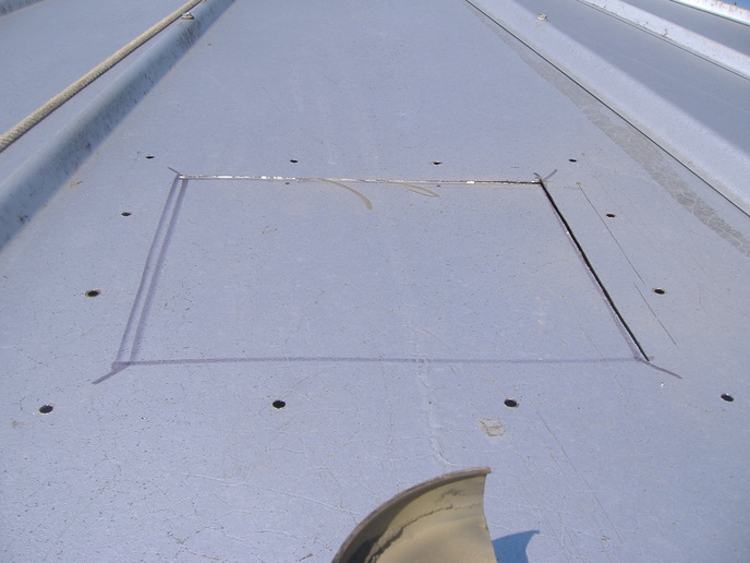

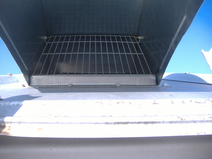

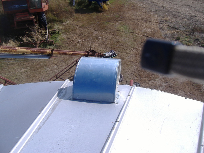

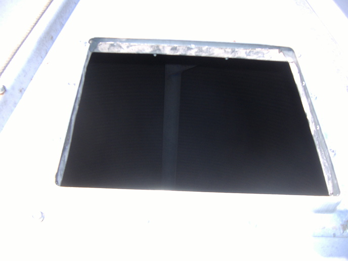

I've installed quite a few, I used a 4" grinder with a cut off wheel to cut the opening. Position the vents where you want them, mark the holes and drill before you cut the hole. Cut the hole a few inches small than the vent size and then cut diagonally to the corners so that after you bolt the vents down, you cut reach in with a hammer and bend the roof tin up so that water can't get under the vent and run into the bin. Caulk is your friend, don't be afraid to use plenty so they won't leak. Most of all, BE SAFE!!!
