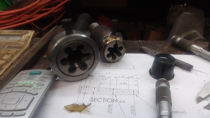

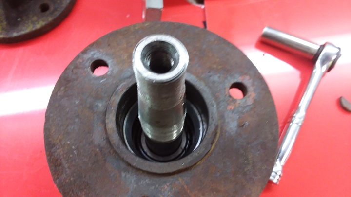

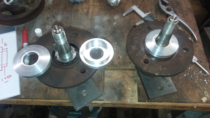

One of the problems with this mower was that the spindles were flush with the top of the mower deck, allowing rain water to get into them. Even though there was a seal, there still was ability of water to do nasty damage. I made aluminum caps that press fit on top. I had to make some die holders for the M25x1.5 bearing lock-nut and 3/4-16 pulley nut. The pic showing the woodruff key sticking out was because I didn't want to tap it in until I was in final assembly.
