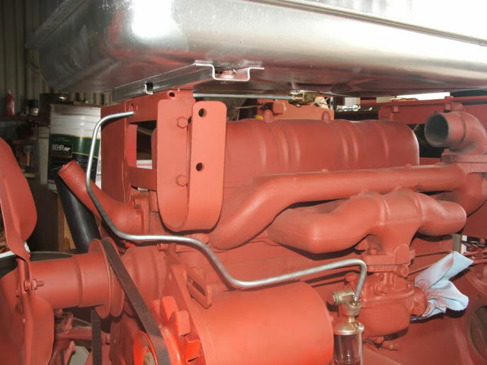

davidl1632, here is a pic somebody posted a few years ago on re-route the fuel line. I plumbed into the shutoff valve on the bottom of the tank and did not use it. Routed the fuel line around as in the pic and added the brass ball valve w/compression fittings. IIRC, I used 5/16" brake line for the fuel line.
HTH
