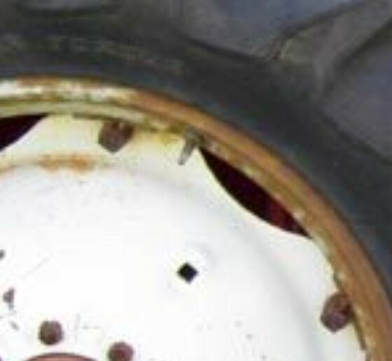

Hi, looking at your photo the valve stem is either been put on the wrong place on the tube or the hole is wrong in the rim.
I tried to find a photo online of a 444 rear rim that you could see the valve stem but this the best I could find.
See how in the photo below the valve stem is sticking up straighter, yours appears to being pushed to the outside of the rim, like the stem was mounted to much to the center of the tube.
I realize the type of stem in my photo is for adding liquid ballast.
