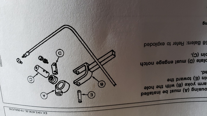

Re: Plunger timing JD 346
Posted by dopp creek on June 24, 2020 at 14:12:46 from (174.204.213.45):
In Reply to: Plunger timing JD 346 posted by dopp creek on June 24, 2020 at 08:11:22:
I figured out what I did wrong. The bearing housing at the pkungerhead end can either be in front (think extending) or swing under the connecting arm yoke. I didnt swing it under, but out, thus explaining why it seemed the plunger grew longer and contacted the needles. I'll go run the tedder for a bit and then pull it apart. Oh the Joy of hay season.
