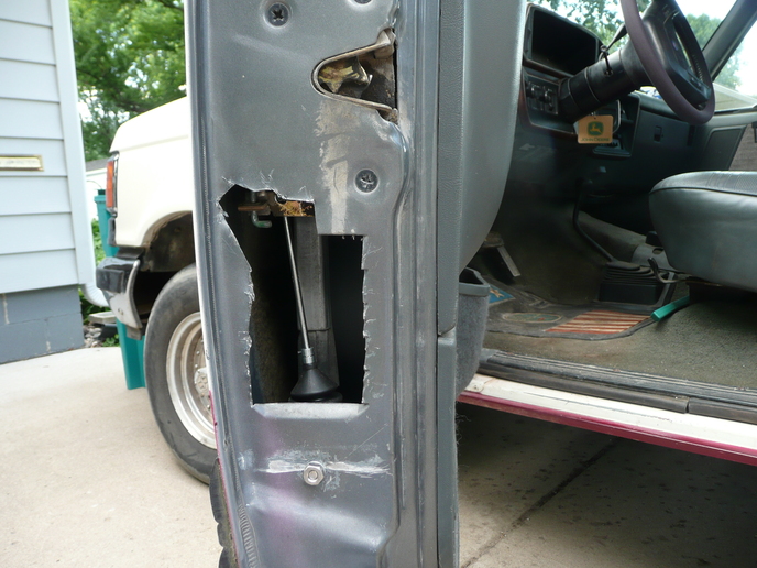

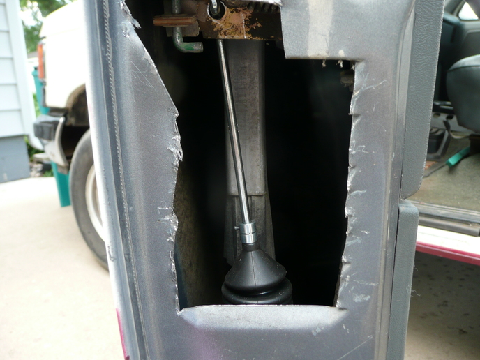

A few days ago (June 20) I posted about an electric door lock failure. The motor
(actuator) was bad. Bought a new motor (they are a bit spendy) and problem is fixed. Had
to cut some sheet metal away for easier access. Covered the "new" hole with gorilla tape. The new motor comes with 6 different lengths of output shafts and the correct one is fastened in with a tiny roll pin. Thanks for the previous helpful responses. (to make it tractor related there is a John Deere air freshener visible below the steering column)
