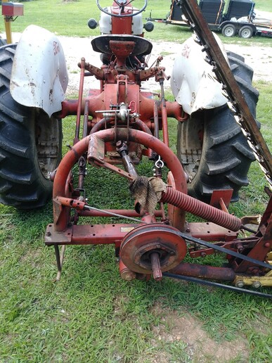

Spent a couple of hours yesterday fooling
around with the sickle mower. Hand spun
it a thousand times. Tried a different
drive shaft, no change. Found 2 loose
sections and wear plates need to slide
forward a bit. But the big thing I took
sway bars off tractor and slid mower over
until the drive shaft was straight. That
seems to have solved the clunking noise.
Now I have to move it on the frame. Then
the spring and cable will need adjusting.
Maybe this is the fix. SV Cummins texted
a bunch helping trouble shoot and Old
called. Plus the help I got on here.
Great site. ( I checked the timing of
mower first, it was good)
Picture is before I slid it over.
Moving it will move the shoe in line with
the tire. I think that's where its
supposed to be.
