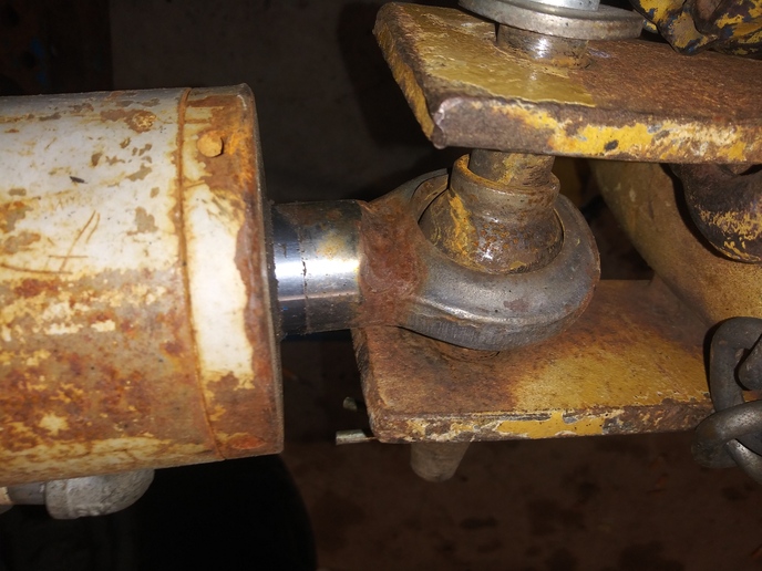

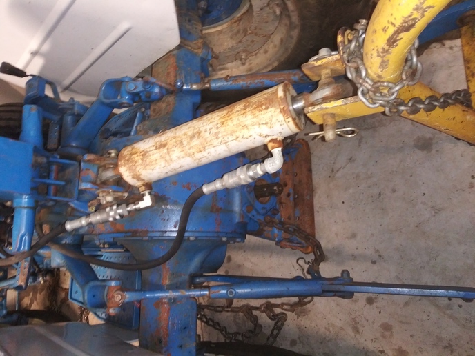

The ones you can buy are rather flimsey things and I thought rather expensive too.
I made my own out of a heavy duty cylinder that I bought on ebay and I cut the swivel balls off of a screw type top link that was bent and welded them on. I think I have about $75 in it.
Hydraulic top link is a wonderful thing. I would cry if I had to go back to a manual one.
