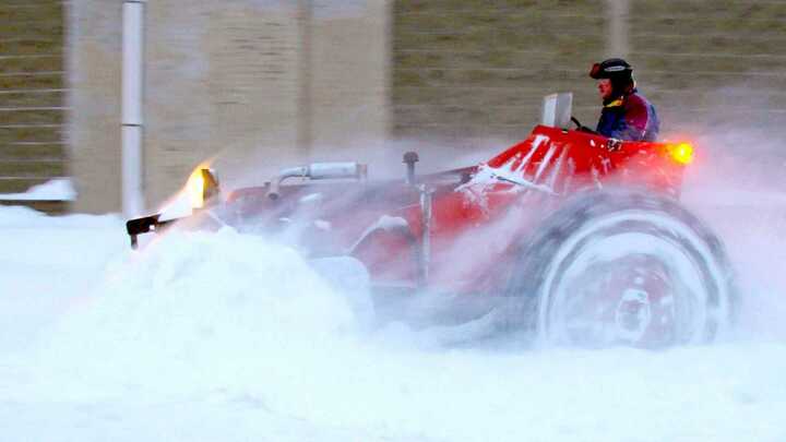

A buddy owns 30+ Farmall H/M/300/400 etc. tractors set up for city sidewalk snowplowing. He modifies them with horizontal mufflers laid atop the hood with the outlet elbow facing 45 deg down (photo).
I've plowed many miles of sidewalks with the outfits - the muffler setup works great!
