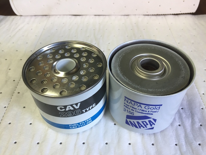

Re: stalling 434 ih
Posted by Dieseltech on October 21, 2020 at 14:17:56 from (64.184.64.57):
In Reply to: stalling 434 ih posted by syco 1 on October 21, 2020 at 13:11:43:
What brand fuel filter? If NAPA/WIX make sure there's NO O ring in the filter top outer groove, that's the fuel inlet passage and must remain open. common mistake to put an extra O ring there as filter comes with an extra O ring for glass bowl applications too.
