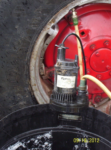

I've done the drill pump and it's terrible slow. Here is how I do it. A basic utility pump short hose and the adapters.
