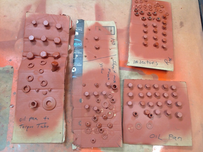

Cardboard is handy to keep bolts of different lengths pushed through on a drawing of where they go, such as the front engine cover. Also good for
keeping together and painting.
