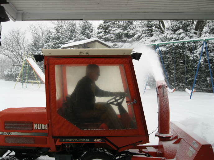

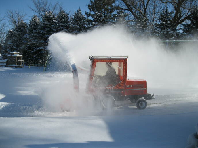

Can't help you with models or anything, but a suggestion. The one I have in my Kubota is mounted in the left rear corner. It came with the enclosure and the fan drew air in the front and blew out the sides. I was constantly fogging up the windshield. I reversed the fan and eliminated the issue. I only use a snow blower on this machine, so maybe plowing won't present the same issue. Sorry, no pictures of the heater alone, but it is about 10" square and 5" deep. It works very well.
