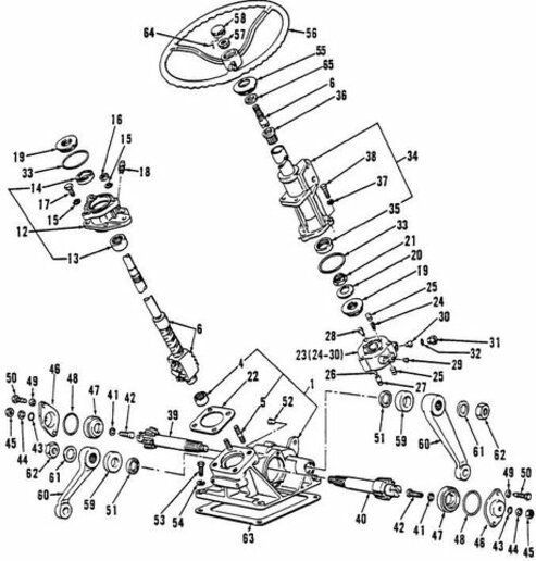

Common problem on those. It's the upper seal #35. Cheap enough to fix but kind of a PIA to get at. Pull the steering wheel, center hoods, throttle, fuel tank cowel.
If he is smart he will also replace the lower seal #14 while he has it all apart or sure enough it will start to leak and he'll wish he had.
